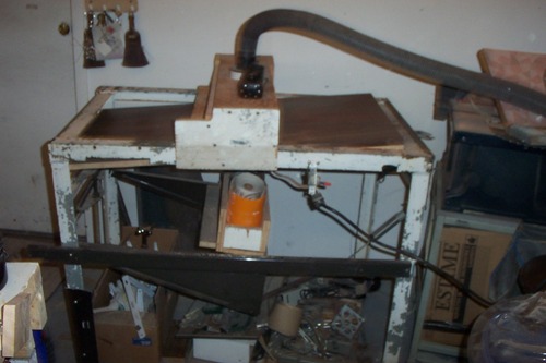

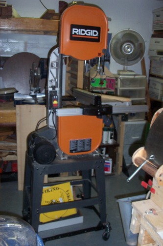

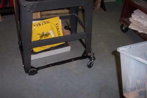

Hi folks, been at it a bit lately, i worked a little on my bandsaw, i added a base with casters and a decent fence that i had purchased at Busy Bee (NO, NOT lEE VALLEY ), the base will allow more space in the shop and the fence, well, it speaks by itself huh?

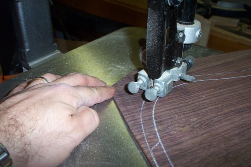

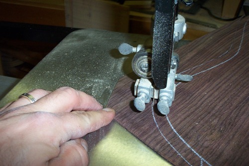

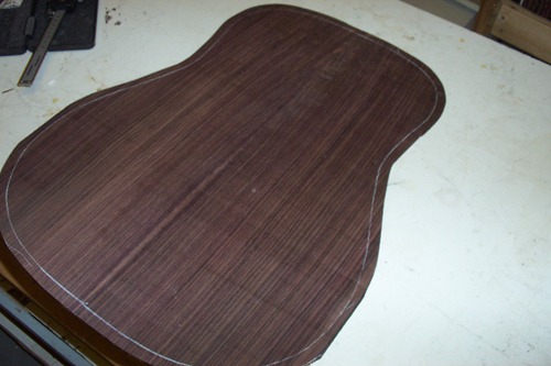

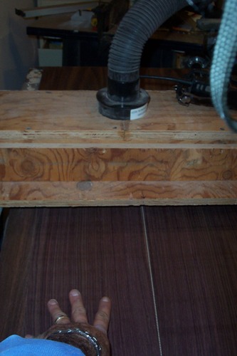

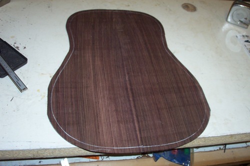

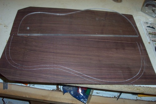

Tonight, i also thinned the back of no 2 though final sanding will be done with a finishing sander. I also cut the outline of the back with the bandsaw after tracing the template on it and leaving a 1/2" space to work with, just a safe precaution.

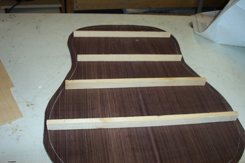

Finally, i precut the back braces and laid them without glue on the back
Here is the base with casters
And here's the fence
The drum sander doin' it's job!
template tracing

Bandsaw moves!
Et voila mes amis!
I should be carving them braces sometimes this week after the glue up, i hope to be able to close the box during the coming week end!

Looking Good, do the castors on the bandsaw lock somehow ? Just had vision of you chasing the saw up and down the shop
Thats a good idea as that way if you need to cut a long board you can just move your saw a bit to give more clearance

Thanks Russ, yeah,free movement and clearance for long cuts was the main factor for buying this and it works beautifully, i forgot to mention that it has 2 strait wheels and 2 casters only, it locks to the floor where you want it by lifting 2 handles and bringing down 2 rubber feet. Like you and Martin said,I wouldn't want to be chasing that beast down the hallways here, it would be hard to know which dentures goes in which grannies mouth after a scary chase episode!
